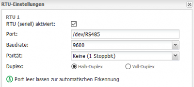

I activated RTU1 and set the settings for this connection to the values according to the manual - unfortunately without success.
I also tested all other options, but the device cannot be found.

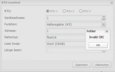

Yes, I used RTU Scan without having a profile for it - now I have acc. want to read out the holding register H0001 according to the instructions - the following error message ;-(

Do you have documentation in EN?
Check cable and make sure GND is connected.

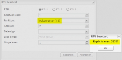

Short intermediate result, if I now query a holding register under RTU read test z. B. H0001 (i.e. 1) I also get an answer from the device!
Here is the picture.
d. H. but that the connection to the device works right?
But then why the error message?
