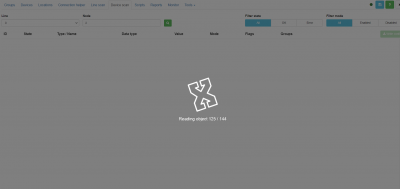

Click here to scan the device, it will read back all settings from the device.

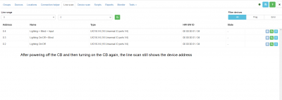

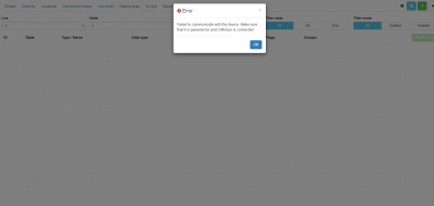

(12.06.2023, 07:09)hoangknx Wrote: (19.05.2023, 10:53)aicanx Wrote: (19.05.2023, 08:50)Daniel Wrote: Contact us via email for a replacement. Attach link to this thread in it.
The UIO16 machine has a Scan Device function, sometimes it can be accessed, sometimes it can't. Once I got access to the scanning device, I had to reselect each group address and save it. The error after powering off and on again has been fixed, group addresses work again. Thank you for the very quick response!
