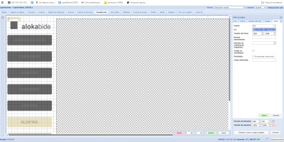

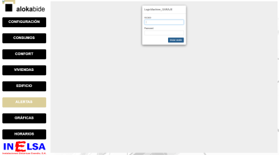

Good morning,
I need some help. I have a LM (IP = 192.168.0.16) where the alert manager and the display of all alarms from a SCADA system are located.
However, the SCADA display is handled by another LM (IP = 192.168.0.11), and I want to configure the alert manager to display the alerts from the LM (192.168.0.16). So, I've pasted the following address onto a screen on the LM (IP 192.168.0.11): http://192.168.0.16/apps/data/alerts/.
But I'm getting a user access request on the display, and I don't know how to remove it. I've attached an image.
This won't work, modern browsers blocks frame access via http and without valid ssl certificate on the controller.
