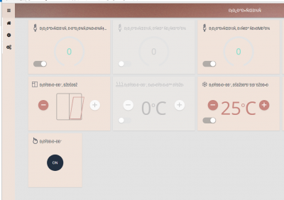

Can you drop your mosaic backup?
Or just write few words in Greek here.

Every word comes from Greek
Make sure you have latest Mosaic and sync to cloud again.
Works for me now.

Hm.. I can't recreate this issue.
Can you just try to create new cloud account on different email and try form it.
And please reboot LM

(30.05.2018, 10:36)admin Wrote: This is still a cloud bug that must be fixed
I know it is a bug but trying to find a way to reproduce it.
(30.05.2018, 09:26)gtsamis Wrote: I might just crashed your system
Unoftunately nothing worked, tryied 2 other emails, reboot, sign in, sign out, sync and still nothing.
Can you please delete all cloud account so i can try it again. (george@tsamis.com, gtsamis2010@gmail.com, info@innob.gr)
PS: Push is the only thing that works
Please try again to sync in the app. It must show sync date and time if success.

Unfortunately nothing worked... sould i send you a pm with access to my LogicMachine so you could check it yourself?

Yes please send it. I'm out of the office today so will look on it tonight.

It is fixed, please check.

Everything works as it should be.
Was it a bug or misconfiguration on our side?

bug
