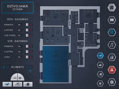

Time in scada 08:00
(31.12.2019, 08:25)Erwin van der Zwart Wrote: Ja Hi,
Just use the object type 10 (3 byte time/day) that is designed for this type of input, if you don’t want the day input you can hide it with css.
I would do this kind of input for heating mode in another way, create a schedule button and a widget with the iframe to a scheduler that controls the heating mode, this way you can make several switching times instread of the 2 static (from-to) times you now have designed in the visu. Use custom values to set the comfort/standby/night modes as text instead of 1,2,3 etc.
The scheduler can control the heating mode directly without the need of any scripting (:
BR,
Erwin
The problem is that i have settings in widget.
I can no call widget from widget.
