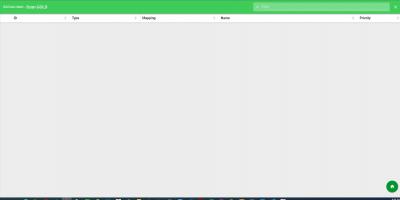

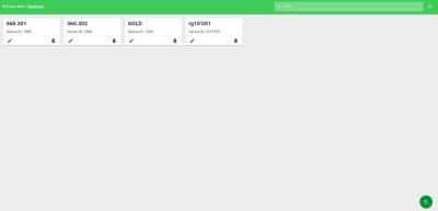

Yes I got the list ,
string: 1200 192.168.10.11
1889 192.168.10.121
1888 192.168.10.122
2107393 192.168.10.115
When I deleted bacnet client app the object appeared in the scada package Smile , but when I do the opposite I can't see the objects from bacnet client app,
I have to see  the objects from the app because it's easier to map them from it.
