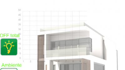

Hello
I've copied the script into custom JS, changing the vis ID to 4.
I have created the .lp file in user and copied the second script.
I have stored a value and with the second script that value appears if I manually load the page ip/user/data.lp
But it happens to me:
If I enter the visualization through ip address//scada-vis the graph is not shown, just a strange symbol and a 0 with a dot.
If I load IP address//scada-vis/#4, I see the grid of the graph, very dimmed and without showing any value.
I would need to keep just the price (value) keys, in the date order 00 first and 23 last and store them in the variable.
Greeting
