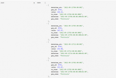

1. I get the prices/hour of the PVPC with the esios api. The result is a Lua table that I store in storage with the name pvpc.
2. I create the data.lp file and save it to user
3. I copy the js script and change it to id4
Result

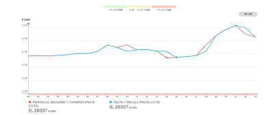

The graph is drawn but the data must be ordered from lowest hour 0 to highest hour 23, and since the price is different every hour, it cannot be that graph that increases.
I want a graph similar to the attached one, which is the one shown by esios.
