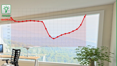

thanks i will try it.
  How can I divide all the values by 1000 so that they are displayed on the graph? And one last request, is it possible for the Y axis labels to show the actual price values of each point, instead of being a scale?
other question

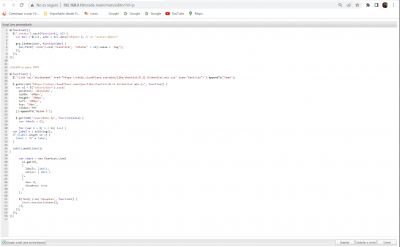

Testing this method on a wiser for KNX HW v2.0 with firmware 2.61, the graph is not drawn correctly.
I attach a screenshot.
I tried all kinds of positions and sizes and it never showed beyond hour 19. The data in the storage is correct and the Json with the data in the data.lp file is fine. And until hour 19 the graph corresponds.
Is it a firmware version issue?
Thank you very much
Greetings
