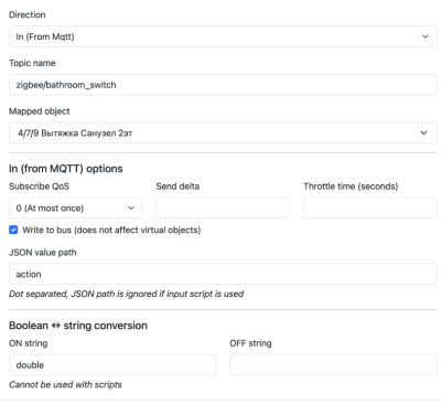

i have found a bug:
if i set up configuration with an empty "OFF string", it will accept as correct configuration, but any value will write TRUE to the target object. Example configuration attached.
My expectation is that any other value will be ignored (i do not expect to write FALSE values in any case, hence using empty OFF string).
