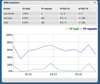

I have a problem with TP repeats like as you can see in photo.
Also i found one IP from ARP table which is very strange for me.
What i did three months ago, i use this LM as master and 192.168.0.101 as slave and i read information by a script from LM.
After that, i turn off both LMs, and few days ago after turn on LM as a simple LM not a server, TP repeats look like in this photo. This LM is now alive on a project. The KNX is works fine but i don't know what happened. I deleted all old scripts and old variables which i used in my exercise with master and slave.
Do you think this IP makes this noise on TP repeats?
Later edit 1: I saw if i try ping to 192.168.0.102 and 150, the LM put these ips in arp table with strange MAC.
So, how delete these strange IPs?
