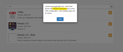

(17.12.2025, 14:04)Daniel Wrote: There is no need for internet if you use local broker. It is just app on one of the LMs
There is no MQTT server, client ets.. Because, need internet Sad
(17.12.2025, 09:38)admin Wrote: Enable "Send Basic auth header" in System config > Services > Remote services. Make sure you have the latest firmware (2025).
The last stable version : 2024.04
https://www.logicmachine.net/downloads
I'm continuing to work on my project based on this version. Will I encounter any problems with my project when I upgrade to the 2025.12 RC3 version? And can I revert back to 2024.04 if necessary?
