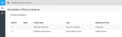

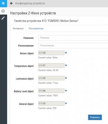

Some screenshots while waiting for the final release of ZWave app for LogicMachine

(29.01.2016, 11:49) edgars Wrote: Some screenshots while waiting for the final release of ZWave app for LogicMachine
i can't wait
