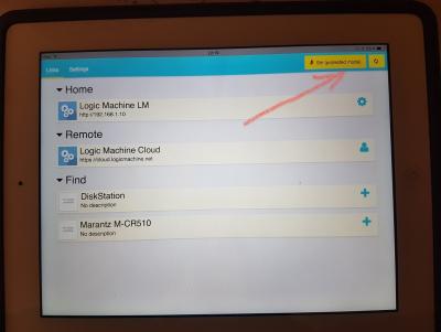

And another remark .... the launch button Siri is very small, inconvenient to press....
23.10.2017, 15:05
(23.10.2017, 14:58)Erwin van der Zwart Wrote: Hi,Hi Just use set value and leave the value field empty. You can then say 'Set light in the office to 55%' Set value will look for the number to use for your object. BR (23.10.2017, 15:03)Igor68 Wrote: And another remark .... the launch button Siri is very small, inconvenient to press.... Which device do you use ? Drop a screenshot please
23.10.2017, 15:33
(23.10.2017, 15:05)Daniel. Wrote:(23.10.2017, 14:58)Erwin van der Zwart Wrote: Hi,Hi

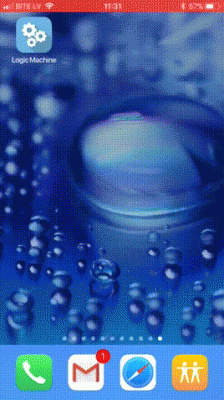

In iOS11 I can't open LogicMachine app. When I try to open then I see only startup screen. After that app closes.
06.11.2017, 08:23
(06.11.2017, 07:48)Maris Wrote: Hi, Hi Strange it works normally on iOS 11 and 10. Which version exactly do you have? PS. There is v 1.0.1 available on the store. BR
Ctrl+F5 (06.11.2017, 08:23)Daniel. Wrote:(06.11.2017, 07:48)Maris Wrote: Hi, I have iPhone 6, iOS 11.1, LogicMachine 1.0.1. |
