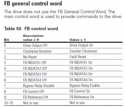

I have to write bits in a 16-bit register (bitmask) see attachment. This is a control-word for a eaton DC1 freq.converter.
On start I have to set
Bit2=Fault reset, and Bit8=Control

This script will set bit 0 if 1/1/1 is on, bit 1 if 1/1/2 is on etc. Adjust as needed and add writing to ModBus register at the end of the script.
1234567891011121314151617181920
function setbit(value, bitnr)   local mask = bit.lshift(1, bitnr)   return bit.bor(value, mask) end value = 0 if grp.getvalue('1/1/1') then   value = setbit(value, 0) end if grp.getvalue('1/1/2') then   value = setbit(value, 1) end if grp.getvalue('1/1/3') then   value = setbit(value, 2) end log(value)
