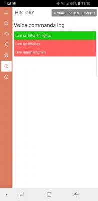

- We can select which device to open automatically when opening the app.  This will allow us to go directly to visu by just pressing the app icon.
- Voice commands are logged in app for easy debugging.  This is only stored in the app.

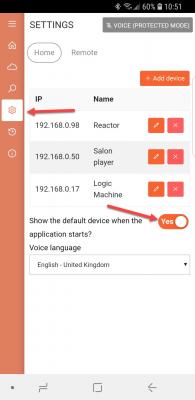

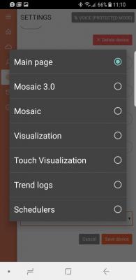

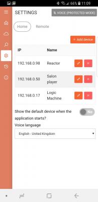

When do you plan releasing iOS version?
How can I select the default LM and run it when app starts? I have 3 LMs in app and checked "Show the default device when the application starts?" and on every LM there is autoload checked but when I start app it doesn't start any default LM.

You need to set one of the device to be default. There is option Auto-load device. Only one should be set this is in LM settings.
When you are in the cloud and you are in Mosaic you can switch view to another LM in top right corner.

(11.03.2019, 11:59)buuuudzik Wrote: "You need to set one of the device to be default. There is option Auto-load device. Only one should be set this is in LM settings."
I've tested it. Only 1 device has autoload on but it is not working (it not runs the default lm when app starts).
"When you are in the cloud and you are in Mosaic you can switch view to another LM in top right corner."
I see this function but both on the browser and on app I have only my devices and no allowed by other users. I am using Mosaic 3.0.
For the auto load it is a bug.  It work fine on my version which I was testing before release. Seems something is different in the version on app store.

Hi Buuuudzik
Can you uninstall the app and install again. I reverted back to previous (beta) version and autoload was working fine now I installed back the version form store and it is also working. I don't see any differences in my configuration.
#60
I've reinstalled the app, added only 1 LM with static IP and set autoload "Main page" and autostart but unfortunately nothing happen when I start app.
I have Samsung S8 SM-G950F, on of the newest Android version.
