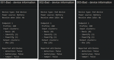

Can you provide a screenshot of the device list and device info for the leak sensor?

Do all water leak sensors that you've paired have the same cluster list?

The app has been updated. Check if you can map your water leak sensors to objects now.
