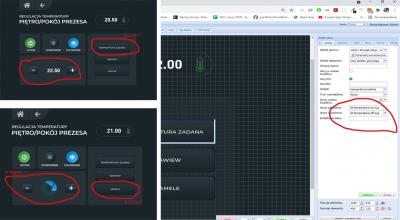

I created 3 buttons in the objects, each of them switches the appropriate widget after clicking, it works fine, but my problem concerns the buttons themselves, which do not change the state of on and off when the widget is started. Although the object tab gives the possibility to change the state of the button's appearance (off icon and on icon). In my case, it changes the color of the button from black to green). I am asking for a hint where the problem is, how to solve it. In the attachment, I am sending a screen with visualization.

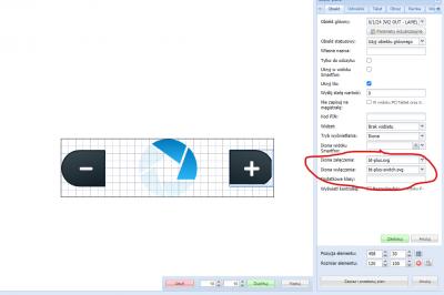

I have one more request, another problem appeared inside the widget, where I have "+", "-" buttons (visualization attached). I would like to switch them after clicking on the button. Toggle style. In the editor, set the on and off icons, it works in such a way that after clicking only one button (for example +), both the "+" and "-" buttons change the state. I need codeI need a code in style toogle buttons. Can you help me?
Do you want to highlight that the icon was clicked? Or do you want the icon to switch to a different one to show which action has been performed (plus or minus)?
(20.08.2021, 08:44)admin Wrote: Do you want to highlight that the icon was clicked? Or do you want the icon to switch to a different one to show which action has been performed (plus or minus)?
I want to show that the icon has been clicked. I want to substitute another svg file after clicking. Something like toggle, first click, icon change, second click, birth to first icon, etc.
You will need to attach an event script to the control object (0/1/24) and create two status objects for plus/minus (32/1/13 and 32/1/14 in this example, change as needed). Then you need to attach status objects to the plus/minus buttons.

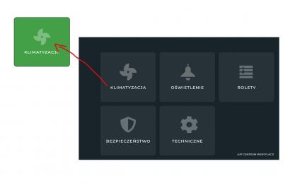

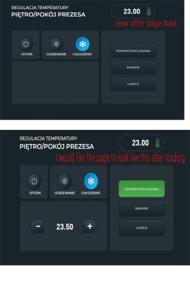

I have 2 questions about how widgets work. First question: In the plan editor, I can only add a witget to the plan in the facility tab, where after clicking the button the widget is visible. Is it possible to insert a widget into the plan without buttons, so that the widget is visible immediately after loading the plan? As I see it in Mozaic 3.0. The second question concerns the operation of wigets and buttons. I would like one of the three widgets to be active immediately after the page is loaded. Now the witget starts only after clicking on one of the three buttons (I sent the visualization).

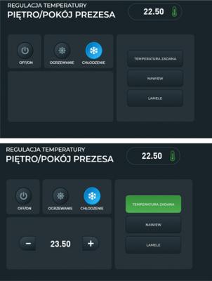

I'll explain my problem again. After loading, my website looks like in the attachment, view1. Only after pressing the button I turn on the widget "set temperature" or "air supply" or "lamellas". I would like the first "set temperature" widget to be visible immediately after loading the page
