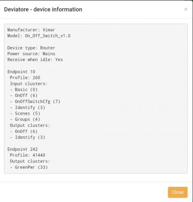

Status won't work without a profile. Can you post a screenshot of device info? Click (i) button in the device list.
(07.03.2022, 07:40)admin Wrote: Status won't work without a profile. Can you post a screenshot of device info? Click (i) button in the device list.
Is it this?
Thanks, we will add this device. You will have to reset it and pair again after installing the new ZigBee app version.
(07.03.2022, 12:07)admin Wrote: Thanks, we will add this device. You will have to reset it and pair again after installing the new ZigBee app version.
Thanks always the best

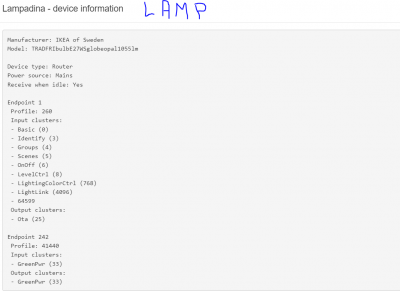

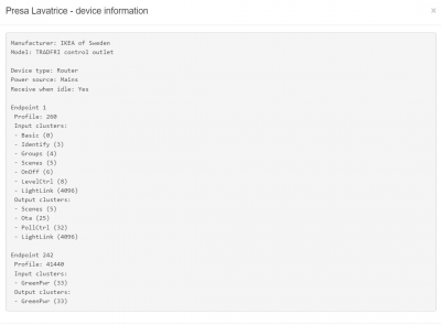

Hi Admin,
I'm testing several device (ikea) in zigbee all works fine with the app. I added the group address but in cmd all work in read doesn't?
Could be because I'm using virtual groups?
Devices are:
- Socket TRADFRI
- Lamp TRADFRI LED
In the attached file the info.
Best regards Cristian
What do you mean by "in cmd all work in read doesn't"?
(14.03.2022, 10:25)admin Wrote: What do you mean by "in cmd all work in read doesn't"?
I have mapped the object. The write command work I can turn on and off the light but the device doesn't respond with the status.
BR Cristian
We've checked the control outlet and the status reports did not work with older outlet firmware. It works with newer firmware but unfortunately we do not support firmware upgrades for Ikea devices at the moment. The upgrade can be done with Ikea Tradfri hub.
