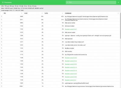

hey guys, i have a question.
I have the W4K / SW: 2.6.2 / HW: 2.X
The CPU / IO laod is permanently above 1.30
This is due to the Cloud Connector and IoT for the Alexa APP.
How much would the CPU / IO load go down if I buy the W4K HW: 3.X ... is it worth the change?

Can you install the Processes app from the store and tell what CPU load do you get?

Hi @all,
I having the same problem with HW 3.1 and firmware 2.6.2. The CPU load is permanently above 0.8 due to the API3 and cloud connector apps. All other processes / scripts are nearly zero.

has anybody heard something from Schneider Electric if they will improve the API3 and cloud connector apps in the near future?
It is really crazy: if I deinstall the apps the machine is running on 0.1 load with the apps I’m most of the times between 0.9-1.1.

New FW (2.8.0) is planned end of this month (at least according latest info i have) and will include the improved / optimized versions of both apps.

Hi guys,
I updated this morning to firmware 2.8.0 and the new apps and the load is much better. The W4k is running at 0.2 before it was 0.9-1.1. Excellent work, many thanks!
