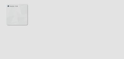

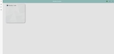

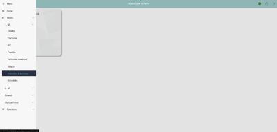

I've been still running 2019 version of Mosaic 3.0 on one logic machine, everything ran great and I wasn't in dire need of any new functionality thus "if it works, don't touch it" was my main approach. Yesterday, I tried loading Mosaic on my phone and I've noticed the loading time being way longer than usual (more than 5 seconds) and after it loaded, I was left with a weird mess where widgets were overlapping, they were missing buttons and backgrounds (see attachment 1.jpg). I tried loading it on PC, same long loading time, after it loaded sometimes there were no widgets at all, after refresh sometimes they would be there but without icons and sometimes they would overlap (see attachment 2.jpg). Sometimes the left side panel for changing rooms loaded, I wasn't able to change rooms though (see attachment 3.jpg). When I tried loading up the editing version of mosaic, it loads a bit longer than usual but it works and I can see everything correctly.

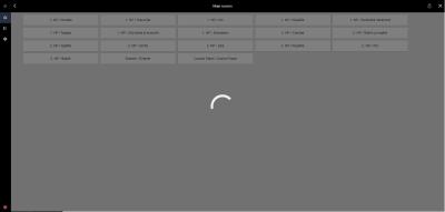

-Then I tried updating Mosaic to the newest version, didn't help but outcome of loading the updated Mosaic 3.0 was a bit different, it didn't load at all. I could see the rooms but it was loading indefinitely (see attachment 4.jpg) but the editing Mosaic 3.0 was completely fine (see attachment 5.jpg).
