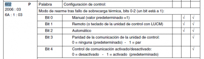

Hello, I am working with MODBUS  module for TESYS U and LM5, but I need to write one bit individually. For example set 602.1 to 1. Could anyone help me please? Thanks

As far as I understand, only one bit from 0..2 range can be set to 1. For this control I suggest creating 1-byte unsigned integer
object and assign custom values (0 = set bit 0, 1 = set bit 1, 2 = set bit 2) to it so you don't have to create binary objects for each bit.
Code:
mode = grp.getvalue('1/1/1') -- 1-byte unsigned integer
paridad = grp.getvalue('1/1/2') -- boolean
control = grp.getvalue('1/1/2') -- boolean
if mode == 2 then
  value = 4
elseif mode == 1 then
  value = 2
else
  value = 1
end
if paridad then
  value = value + 8
end
if control then
  value = value + 16
end
log(value)
