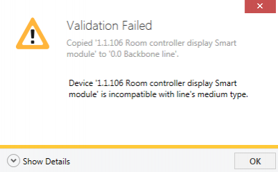

This is what it says when I try to copy/paste special it, first a box comes up where I choose that I want to keep the group adresses and then an error.
Check your backbone settings (probably now set as ip backbone) or add it to the line 1.1 instead of the now selected backbone.
