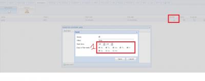

In LM5 there are Schedulers section (located next to the Scripting section). This part, we can manually change the timer (outside the interface into the Schedulers).
As shown in the figure, I now want to get (GET) the data in this region 1, and save it to an object such as 1/1/1. For example, take the data of the time "Start time", get the date "Days of the week".
Who can get this data can show me, with a script? I am very very thank you everyone!
