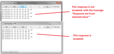

Hello, I'm trying some integrations with Modbus RTU slaves.
I am simulating the slaves with Modbus Slave software and an usb rs485 converter to see the traffic between te Master and the Slave.
I am using the "RTU Read Test" option and I am observing a strange behaviour.
The telegrams are exchanged fine but I get "Response not from selected slave" !!
I tested with a cheaper usb converter from ebay and with the same traffic comunication the response is accepted !
[Image: rtu.png]
The traffic is the same ! the configurations are the same !
I'm not understanding why this don't work with my usb converter !
Any indea ?
Thank you

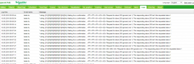

Disable RTU port in mapper and use this script to show what LM sees during communication in Logs tab. Change port parameters, slave id and register address as needed.

Hello, thank you for the feedback.
I have used your script and the frame received by the master is the same from Modbus Slave software Traffic log !
The result is here:
EDIT: The frame sent is the same, but the response from the slave is a bit strange, comparing with traffic log !
In those requests you can see an almost successful frame at 09:57:21.
There is a byte <FF> preceding the correct answer.
this is a bit strange !
