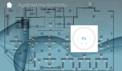

Changing size didn't worked.
I attached 2 screenshots. One of them has %300 size . Other has %200 size. As you can see size are same in both screenshots

As description says this works only in show control mode.
.popover.control-circularslider {
transform: scale(2)!important;
This should do, it will change all sliders.
