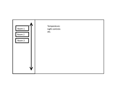

There should be a part on the left side of the plan which is scrollable (list of rooms). When i select a room the right side should show information about the room and controls (temperature settings, etc.). I need the list to be scrollable, because there is a lot of rooms (28 to be exact) and I need to fit them in an intuitive way to access them. I will attach a sketch.

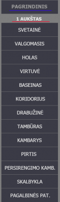

I would like it to look something like this image I've attached. There needs to be additional labels for grouping rooms (marked red). The sidebar also doesn't show which room plan is opened at the moment (the button text should be grayed out, marked blue). Thanks for the help so far!
This should provide something similar. You need to enable dark theme in Utilities > Vis. configuration. Use levels for grouping.
.usermode .menu {
  background: #7E7E7E;
.usermode .nav-main .icon {
  display: none !important;
.usermode .nav-main li .a,
.usermode .nav-main li .a:hover {
  text-transform: uppercase;
  background: #3B3B46 !important;
  color: #E4E4E4 !important;
  padding: 16px 8px;
  border-radius: 0;
  text-align: center;
  box-shadow: none !important;
  font-size: 16px;
.usermode .nav-main li.disabled .a {
    color: #989898 !important;
  font-weight: bold;
.usermode .nav-main li.active .a {
  background: transparent !important;
  font-weight: bold;
