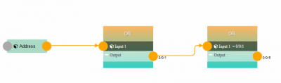

Hi. I thought that was what i have done already. In the picture the top one is adress from "event elements", and the bottom one is adress from "elements". The "event elements" have an orange cirkle at the right side. The once i have used in my coling thermostat project altso have an orange cirkle at the right.

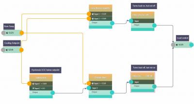

Here is the latest diagram i have tried. There is an red square around a block, and the error says this is missing an event.
Your output to the input of filter is missing trigger event.  Simple rule it is like that. Orange lines are trigger events, where grey are just pure values which do not trigger the block.
When you link empty output with input then in the background storage is created which will transmit value from one script to another but this will not trigger the input block only will wait on another input to trigger. In your case is missing.
What you have to do is select an grp address for the output and then link it to the input. It will then ask you if this is event link. Say yes and then line will be orange.
Like that
