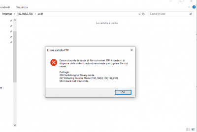

Yes, but you have to use apps account and upload to user directory
I can't write in user directory with apps account.
What is the problem ?

Try using a separate FTP client like Filezilla.
(06.03.2019, 08:39)admin Wrote: Try using a separate FTP client like Filezilla.
I tried....there is a similar error (Critical Error)
I think the problem is with HW 1 of HomeLynk (FW 2.3.0).
On an other device with HW 2.0 this procedure works properly (FW 2.3.0).

I tried it on the same HW and SW and all works fine. The issue is related to ether your HW or your setup.
There might an issue with permissions, try running this script once:
os.execute('chown -R apps:apps /data/apps/store/user/; chmod 0755 /data/apps/store/user/')
