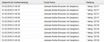

I have several system messages in the wiser concerning the scripts for differentiaiton of shot and long button press.
The messages can bee seen in the picture attached and says for example: "*string: 32/1/7".
32/1/7 is the bit-object which is send by the Enocean profile when pressing the button for blind down and is the trigger for the script.

Can you tell me, what the system message would tell me and what could be the solution?
Kind regards
#10
Hi
This is just log from this line log(address) and you can delete it as it is not needed.
BR
