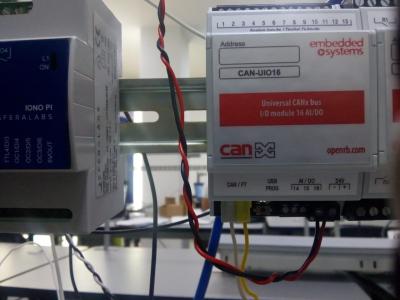

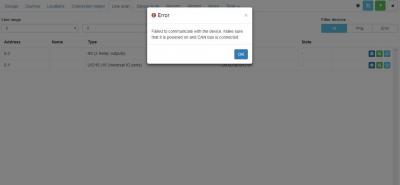

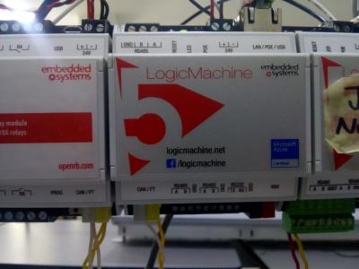

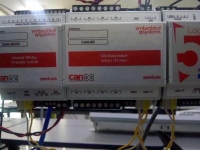

		Good companions, I am having problems with a 3 CanX product installation (LogicMachine5 Power LM5p-KC, canX universal 16 channel I / O, canX 8 channel 10A relay). Both are powered by the same 24 DVC source and have their respective Canx cable (the same yellow and white cable used in KNX). The problem is that in the Logic Machine, sometimes disappears and the Canx icon appears in the Apps, so sometimes I can enter it or not. On the other hand it is happening to me that I can scan the devices and the LM finds them, but when I try to change the physical address, I see an error which I put on the image and it does not let me change the address. Thanks and I will be to your messages.
