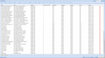

I've trend logs which save absolute value with parameters: 1 min data: 10 days, hourly data: 1 year, daily data: 2 years. So I should have the 1 minute readings available for 10 days... right?
In the latest LM4 Trend viewer interface I can get only 1 value per hour.

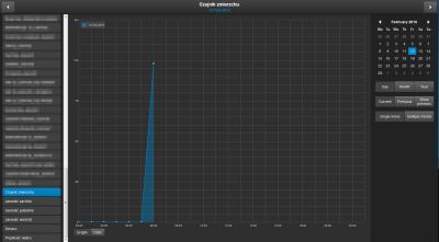

Also an addidition "week" to current presets "day", "month", "year" would be very favoured. In my case already the "month" graph is useless, with having only 1 reading per day. I've added a screen too:

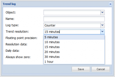

We have plans to improve trends in the next firmware release. You will be able to select sampling rate, with minimum being 5 or 10 minute intervals. Higher sampling rate is not possible due to disk space and memory requirements. Weekly view will be added as well.

Sneak peek of upcoming FW Cool
(08.02.2016, 08:17)admin Wrote: Sneak peek of upcoming FW Cool

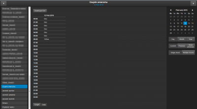

How can I see the 1minute data view or how can I export this data to external application? I also select a 1minute data for 3 days and I have only Hourly data. A similar situation is also in csv file when I open it in Excell.

1 minute data cannot be accessed directly. We will provide export examples when new FW is released.
