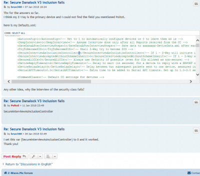

I have som problem including my danalock to the z-wave Application. It find`s it in the network, but I can`t operate it or get staus from it.
I have read onĀ other forum`s that some had to get it in secure mode. On the Z-wave.Me forum there was ond that had to set
var (SecureInterviewAsInclusionController) to 0, see attathement.
I don`t know if this is possible in the LM??
