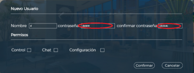

Traté de seguir los pasos pero arrojo este error
Can you post a screenshot with how your current visualization looks like and which field value you want to hide?
son una cadena de caracteres de 255 bytes
