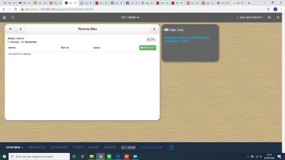

In main page is ok but in the page shown enclosed no.
That's because you are using different element style there. Try this:
.widget-custom h4 { white-space: pre-line; }
(20.04.2020, 11:29)admin Wrote: That's because you are using different element style there. Try this:
Thank you Admin. Now it is right.
