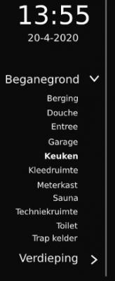

is it possible to create an nested menu / collapsible menu like the picture i attached?
( in the pc / tablet visualization )

Yes I've seen that post, but that uses the "system" menu/ mobile visualization and im looking to create a own menu..
Nearly anything can be done via Custom JavaScript but you will need to it manually from scratch - create required HTML elements, assign actions to menu items etc.
