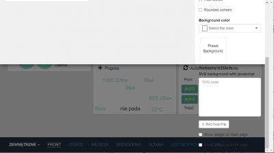

I found a bug with scrolling in controlĀ settings which are longer than screen height. Now I am using fast fix by overflow: scroll on settings element.
Another little issue is with icon of Widget Creator which land at the bottom of a page instead of this widget box.
And also probably text align not working, Ive tried Right and it still looks like it would be Left.

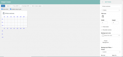

In Wiglet creator element goes always to top left corner. Describe your widget settings it might be something specific.
The alignment works only you have to set the width, Otherwise size is automatically adjusted.

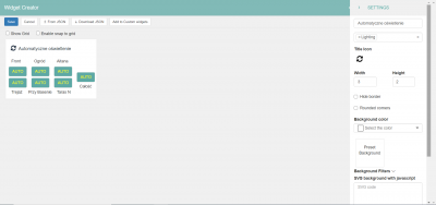

Here you have some screenshots

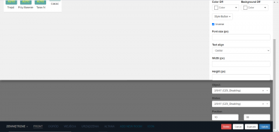

Fullscreen is 1920x1080px, on that screen (first picture) is little issue with overflowing but still it is possible to click save button. But when resolution is smaller (app in window) then scroll ends before content.

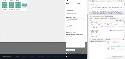

Here is the worst case
Please also check this, but this is probably because i resized window.

Below small temporary CSS fix:
.panels.visible {
display: flex;
flex-direction: column;
height: 85vh !important;
overflow: auto;
.panels.visible > .panels-close {
flex-grow: 0;
.panels.visible > .body {
flex-grow: 1;
overflow: auto;
Done is better than perfect
We have this fixed in beta version(not store one).
