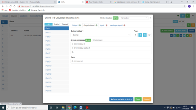

But there is a things that I cannot sort out. I would like to delate a group address link to a port of a device. I enclosed you a picture.
I see the "X" but group address is not delated.
What do your suggest please?
Do you have the latest CANx app installed?
(21.10.2020, 07:30)admin Wrote: Do you have the latest CANx app installed?
Yes, 20200704. There is not update option.
LM5 Lite Canbus (no KNX) is 20200727.
Browser cache? It works for me.
Open browser dev tools (F12) and see if there are any errors when you try to delete an object.
(21.10.2020, 07:48)Daniel. Wrote: Browser cache? It works for me.
I clear cache and I try with other browser without success.
There seems to be some bug in Chrome, we will look in to it. Use Firefox for now.
Update the app, it is fixed.
Thank you very much Daniel.
