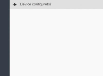

Z-Wave app not loading on LM5p2-RDE
Your support is needed to figure out why Z-Wave app is not loading properly on a LM5p2-RDE equipped with a Z-wave.me USB stick. Below you can find the Z-wave related running processes and system log.

Thanks for your support
All the required processes are running. What do you mean by not loading properly? Have you tried rebooting LM?
(04.01.2021, 07:13)admin Wrote: All the required processes are running. What do you mean by not loading properly? Have you tried rebooting LM?
See enclosed JPG screen capture for the Z-Wave app on the LM5
https://"my-home-IP-address"/apps/data/zwaveapp-imx6/
let me know what other information is needed to understand what's going on
Check for any errors in the browser console (F12).
Issue has been resolved by switching the LM5 server from serving over https to serving over http.
If you were aware of this issue, is above the only way to get resolve it?
see below the console output:
Mixed Content: The page at 'https://192.168.1.55/apps/data/zwaveapp-imx6/' was loaded over HTTPS, but requested an insecure stylesheet 'http://fonts.googleapis.com/css?family=Roboto+Condensed:300,400'. This request has been blocked; the content must be served over HTTPS.
script.js.gz:6
Mixed Content: The page at 'https://192.168.1.55/apps/data/zwaveapp-imx6/' was loaded over HTTPS, but attempted to connect to the insecure WebSocket endpoint 'ws://192.168.1.55/apps/data/zwaveapp-imx6/ws.lp?hid=-928983241'. This request has been blocked; this endpoint must be available over WSS.
e @ script.js.gz:6
script.js.gz:6
Uncaught DOMException: Failed to construct 'WebSocket': An insecure WebSocket connection may not be initiated from a page loaded over HTTPS.
