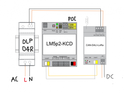

Hello Sir,
I connected CAN /LoRa DALI gateway with LM5p2-KC_V19-22PT-20 by CAN bus. I used DALI power supply mean well DLP -04R for DALI power but when I connected DALI power with DALi port of can/Lora dali gateway the dali power supply indicates the dali bus is short. The DALI voltage at DALI port is 3.3v .So how to solve this problem.
Please provide your wiring diagram.
(03.01.2022, 13:41)admin Wrote: Please provide your wiring diagram.
Try swapping the DALI power supply wires (1/2)
