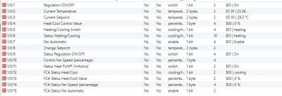

Oh thank you very much . The fan will be with % and these are the GA I want to control

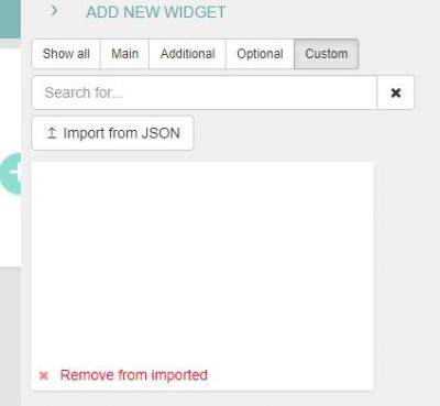

And I am downloading the file you send me but I cannot see anything
I made one from the start and seems its working great! Thanks!
