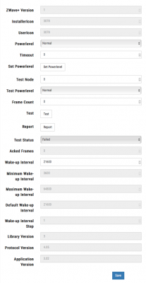

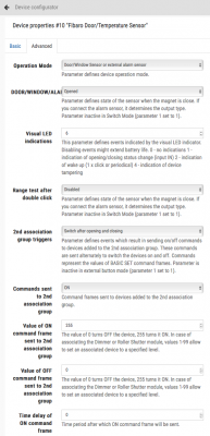

see screenshot
#22
OK, so there is clearly something wrong with my Fibaro device. Or an incompatibility with the Z-Wave app...

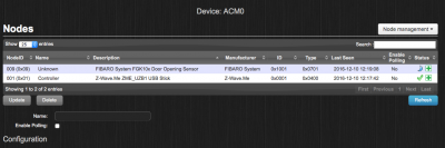

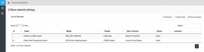

OK... it looks good in Domoticz.
I think there is something with the Z-Wave application inside LM4, it does not looks discovered correctly there...

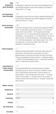

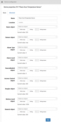

I need to buy another 1-wire temperature sensor, because the one which I've had it with this sensor I've connected it directly to my LM4 and sits now inside the electric panel.
Overall I think it looks better now. Did you changed some settings in the Device Properties "Advanced", so that you see the temperature in the "Basic" tab?
#30
(11.12.2016, 19:43)andeug Wrote: I need to buy another 1-wire temperature sensor, because the one which I've had it with this sensor I've connected it directly to my LM4 and sits now inside the electric panel.
nope, i didn't change a parameter to use temperatures.

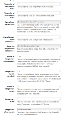

Hello, i have new door/window sensors and the same problem. But it looks like it has something todo with the include procedure. If i do the following steps it works for me:
- activate battery
- close sensor case
- set lm4 to include
- push the button on the bottom of the sensor 3 times (quick)
- wait for minimal 1 minute so all parameters are transfered (if you do not, then some parameters are missing and excluding of the sensor crashed the zwave deamon).
