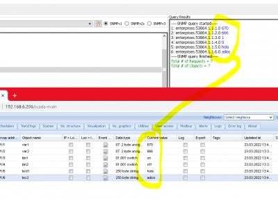

Thanks!!! I will try this solucion! thank you for the quick answer!!
It's working!!One more question: with this example it allow querys from one single IP. Is there a setting that allows querys from any ip inthe LAN?This is already OK to me! but I would like to know!Thank you again!!

(23.03.2022, 12:55)Great!!! it works fine. Thanks admin!admin Wrote: You can allows access for to the whole subnet like this:
12
rocommunity public 192.168.1.0/24 rwcommunity private 192.168.1.0/24
