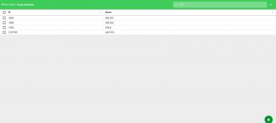

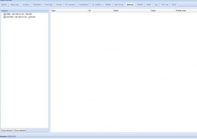

1 - The BACnet SCADA packages detect only 1 AHU and 1 heating central but in the network, I have  3 AHUs and  1 heating central ( I can see 4 of them from YABE )
2 - When I press on scan selected on the BACnet SCADA packages interface, it keeps scanning for 1 minute, and then it shows an error  " Cannot run a scan while local BACnet server is running on the same port ", I already changed the BACnet port to 47809
3 - From the BACnet client app I can see all of the BACnet devices but when I scan any of them they don't display any BACnet point.
I hope you could help me with that.

When I deleted bacnet client app the object appeared in the scada package Smile , but when I do the opposite I can't see the objects from bacnet client app,
I have to see  the objects from the app because it's easier to map them from it.
