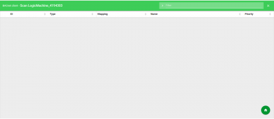

Hi,I used two LMs for bacnet application testing, one for the client and the other for the server,
I installed the ". ipk" file on the attachment on the client's LM. I successfully found the server LM, but I could not find any data points on the server. It can be determined that I have selected the 'Server enabled' function for the bacnet server LM, and I have selected the 'Export' function for the knx group objects in the LM.
Can someone help me? Huh Thank you in advance.
Attached, I also uploaded a screenshot of the LM bacnet client.

Are you doing it on same LM?
No, two gateways are used, one as the bacnet client and the other as the server. The image in post 1 is the client LM.
