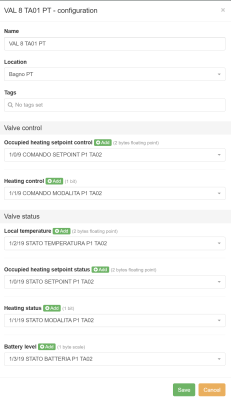

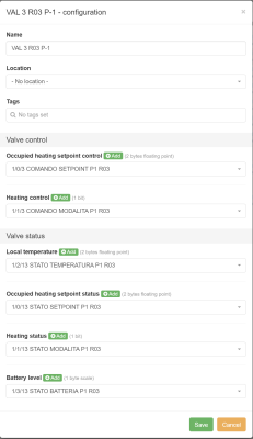

Recently, I went back to work with these smart valves, but I noticed that the "Heating control" address sets the valves either off or automatic, which is bad because they do not seem to work in automatic. I also noticed that if I were to set the Heating from the Zigbee control webpage, then it works flawlessly. Is there a way I can change the "Heating control" address to "OFF" and "HEATING" instead of "AUTOMATIC"?
@Andrea Becagli, see PM
