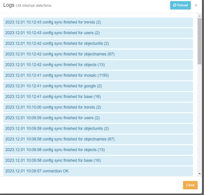

Go to LM Cloud app and show what the logs says.

If you didn't configured any devices in Google Home app then the message displayed above is 100% correct.
