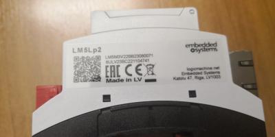

In a batch of 10 LM5Lp2 (i.MX6), I have two pieces that have a firmware version 20230612.
We are unable to update this firmware to a later version by detecting a "Signature verification failed" error.
Any suggestions?

Send the image of side label.

Well, Daniel. It's strange to understand.
The version downloaded with the link you posted now works correctly.
The same FW version downloaded from your repository (multiple times), and which we have installed on dozens of other devices, does not work.
Ok, problem solved (but not understood).
Thank you very much.
