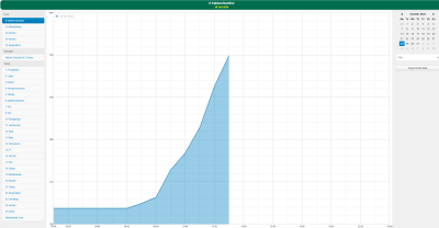

Is it possible to have a graph with selected trends, from the trend log, directly in the visualization, without having to press to go to trends nor have a widget pop up etc.? Like, having the graph shown in the main page.
Thought it might be somehow fetching the selected values from the trendlogs and displaying them afterwards.
Thanks!

Use frame for this. There is Direct link in trend tab for displaying particular trends.

This is hiding the multiple select
.trends .btn-group {
display: none !important;

Thanks! That made it possible to navigate properly in trends.
Any solution for the viewing of the last 7 days instead of monday through sunday?
Posts: 8869
507
At this moment the weekly view is fixed Monday-Sunday. We will consider implementing other view later.
