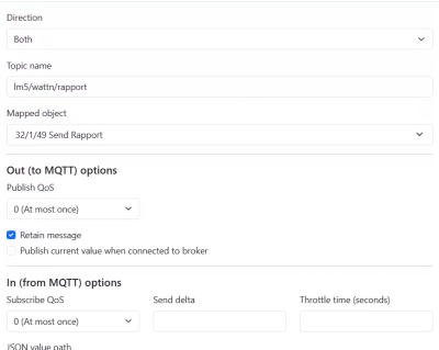

Hey,
I have a 1-bit GRP address with MQTT direction set to Both. Reading works fine in both directions, but writing has a problem:
Send false via MQTT → LM5 gets true
Send true via MQTT → LM5 gets true
My script:
return json.encode({
value = value,
dataUnit = ' ',
state = value
Tried removing the state field too, same result.
Writing from lm5 works fine ,

What is the data format do you expect in MQTT for true and false?
#90
Set JSON value path to value
#91
(Yesterday, 09:50)admin Wrote: Set JSON value path to value
same ,
https://streamable.com/pw3spz
please watch this , https://streamable.com/pc235o
#92
Do you have any script in the 'In (From MQTT)' you should remove it and as admin mention just put value in JSON value path in topic config.
#93
(Yesterday, 10:50)Daniel Wrote: Do you have any script in the 'In (From MQTT)'  you should remove it and as admin mention just put value in JSON value path  in topic config.
After those changes i cant control the object from mqtt, https://streamable.com/qq4ket
#94
See this
https://app.screencast.com/6OFlzxeNzQcuk
#95
Boolean <-> string conversion ON/OFF strings must be empty. JSON value path must be set to value
